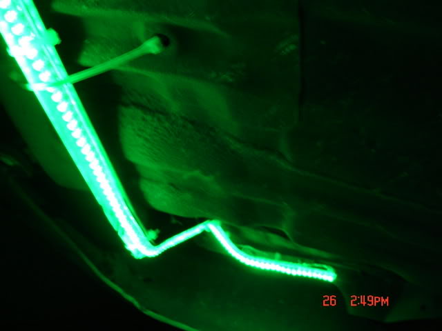

PLEASE use some angled steel to HIDE THE BULBS!!!!
it also protects them... U channeling will be the best but depending on how large the bulbs are youd need to use just a common L channeling that is large enough to hide and protect the bulbs.
i used some U channeling on my old setup and i used some VERY SHORT self taping screws... only about 2 or 3 needed to secure the channeling. and the rest you can just use some zip ties to hold the light to the channeling.
and its best to attach the lights to the channeling first, then slap some tape over the lights and use some black spray paint to basically just hide the channeling.
dont just slap it under the car... if you do youll be the typical ricer with the lights hanging under the car which can be seen if powered On and Off and even worse at night since you can see the lights 2 blocks away instead of the light output onto the ground.
you want the light to be visable on the ground and the ground ONLY and only visable when you turn them on DAY OR NIGHT!
this was my civic. and the light that is lighting up the bottom of the bumper is the light reflecting from the ground and back up

i used flexstrip leds which are the best IMO for underbody lighting since they can be in 6ft lengths, then and flexable which works great!!!!!
