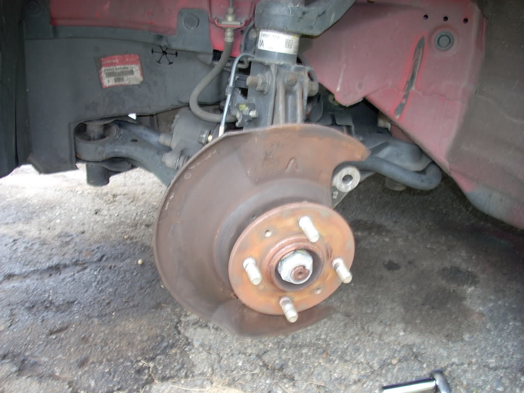

when you take your wheel off you'll see that picture which is showing just the dust shield. Yours will have the disc rotor in front of the shield. The shield sits behind it. Basically the shield sometimes warps/bends and starts to rub on the rotor. Simply push the shield back on the bottom, bottom/left, left, top/left, and top points and that "brushing" sound should go away.
I think I've had to do this twice on my car, once I hear it I know immediately what it is.
If you're running on stock wheels/hub caps can't you just pop the hub cap off and stick on a screwdriver through the little holes? Save yourself some time.
