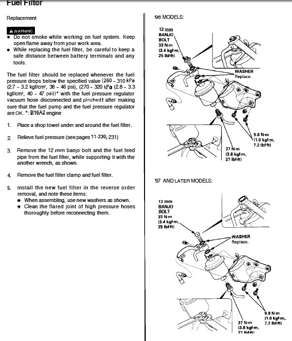

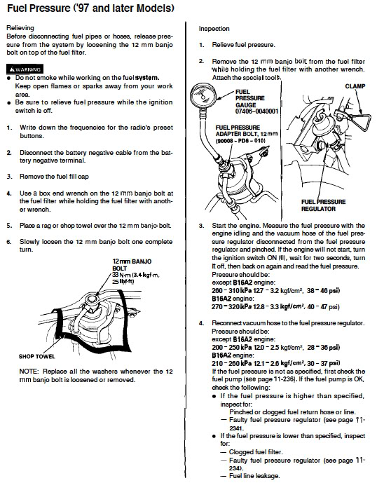

I didn't think the 2000 Civic has an A/C filter, but I could be wrong.
Here's how to replace the fuel filter:
