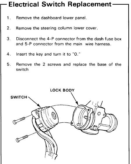

i dont get continuity between all of them.....
What terminal pairs lacked proper continuity? I would have expected lack of continuity between the battery and IG1 terminals with the key in the ON(III) position. I would have also expected the presence of continuity for some pairs with the key in the ON(0) position.
Call your local Honda dealership and auto parts store about purchasing a replacement switch:

so its the white switch and not the piece that you insert the key correct?
Also, if the switch is bad, how would the car still try to turn over, the starter does work.
Old Feb 8, 2009 | 06:46 AM
  #23
mk378's Avatar
Posts: 10,023
There are different circuits in the switch for different functions. So it is possible to have one that will operate the starter but not power up the ignition. This doesn't sound like your problem though. Do the oil and charge lights on the dash come on when you turn the key on but don't start? The oil light should also stay on at least for a short time while cranking the engine though it does not start. These lights are powered by the same circuit in the key switch that runs the ignition and the ECU.
What terminals and positions of the ignition switch failed to show continuity?
Old Feb 12, 2009 | 07:12 AM
  #25
Aaron_EX's Avatar
Posts: 385
okay, the switch is good, i just checked it again and everything checked out. But still not getting any spark.
