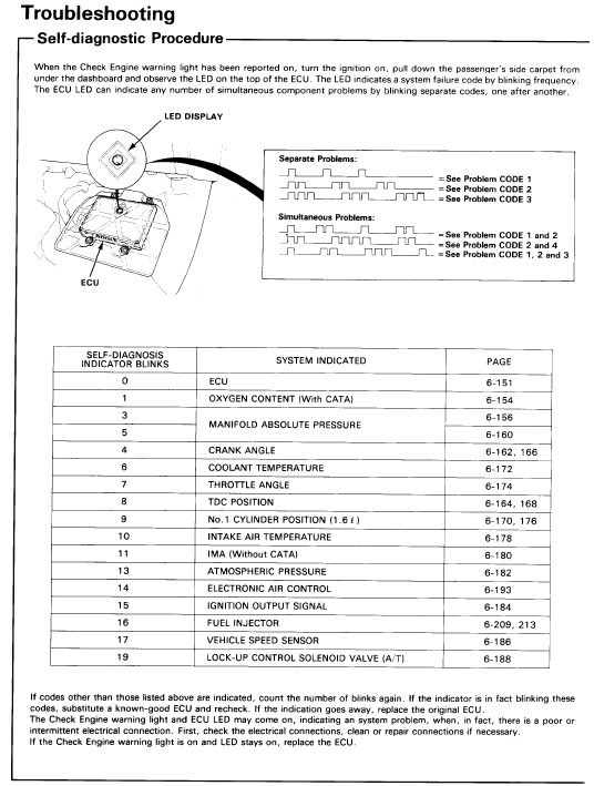

Sounds like an ignition switch problem.
Any CEL codes?
