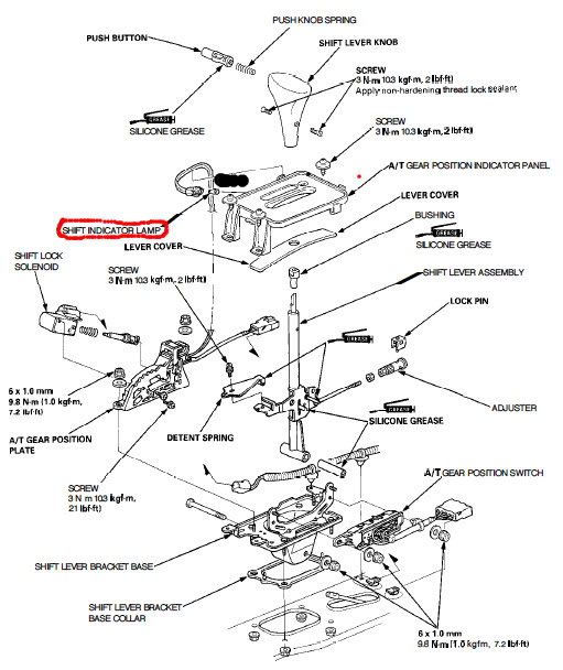

Hi. The light that illuminates which gear (Park, Netrual, Drive, Drive2) the automatic transmission is set to no longer lights up. My guess is a blub burnt out...or maybe fuse. Does anyone know how I can fix this issue?
Thanks
Lt

I agree. Sounds like a blown bulb:
