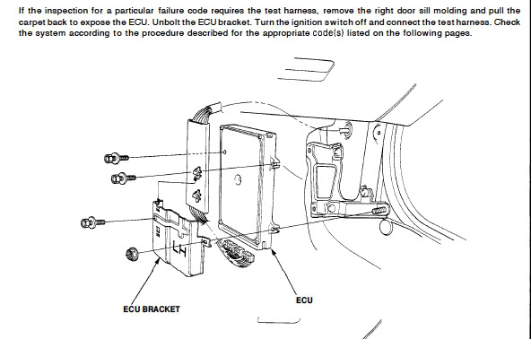

The YEL/GRN wire that is attached to the igniter measured 8 vdc to engine gnd.
Hmmm. This voltage should have been ~10.6V. Disconnect the Yel/Grn wire and measure voltage from the same terminal where you disconnected the Yel/Grn wire. Also check that the Blk/Yel wires attached to the coil and igniter unit are clean and tight. Do the same for the Wht/Blu wire.
Is this ECU connector one the ECU under passnger dash?
Yes, see diagram.
