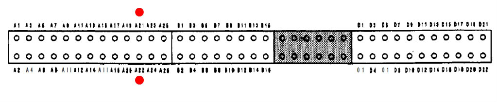

Based on your observations, the next step is to test the Yel/Grn wire attached to the igniter unit. Turn the key to ON(II). What voltage to engine ground do you measure?
Next test the Yel/Grn wire for lack of continuity or a short. With the key off and the Yel/Grn wire disconnected from the igniter unit, test the Yel/Grn wire for a short by looking for continuity to ground. Finally, disconnect ECU connector A and test for a break in the Yel/Grn wire by looking for lack of continuity between terminals A21 or A22 in ECU connector A to the other end of Yel/Grn wire in the distributor.

The YEL/GRN wire that is attached to the igniter measured 8 vdc to engine gnd.
The wire had 88kOhms of resistance
Is this ECU connector one the ECU under passnger dash?
