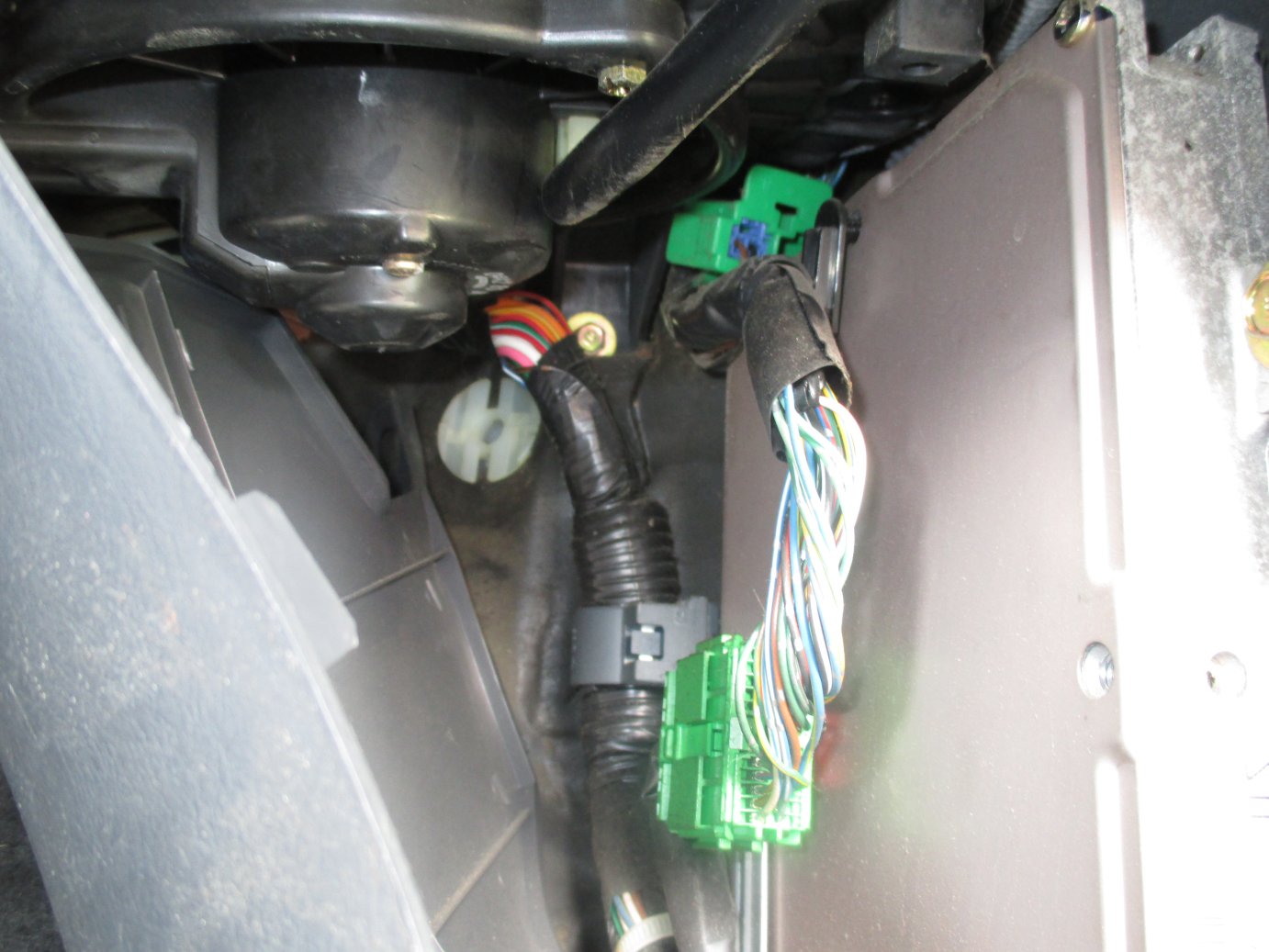

I'm trying to read the codes, but I don't know how to do it. I've seen so much info online but it's conflicting, maybe due to vehicle year or left or right-hand vehicles. I dunno. I'm trying to get to a green plug near the passenger's floorboard, but I don't see it. Do I have to unscrew something? I'm going to try to read it with a paper clip.
UPDATE
I think I removed the panel covering where the plug is supposed to be. I went to another site that said it should be blue, and not green. I don't know. I dunno what to do from here. Here are some pics of the panel I uncovered on the passenger side, and for kicks, under the hood of my car.
UPDATE
