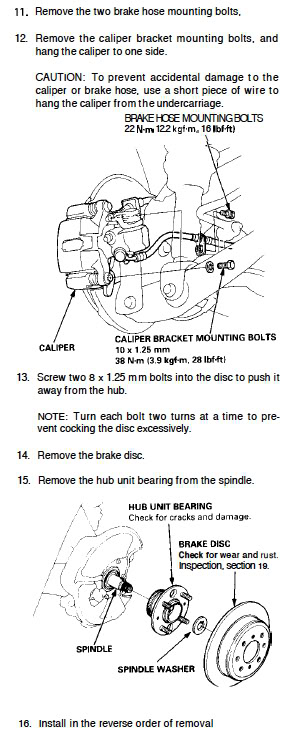

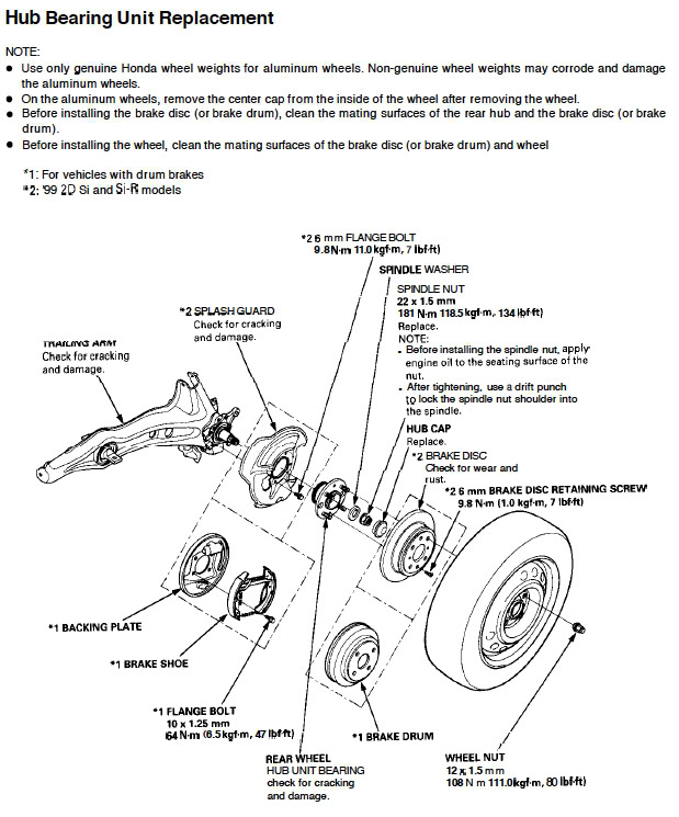

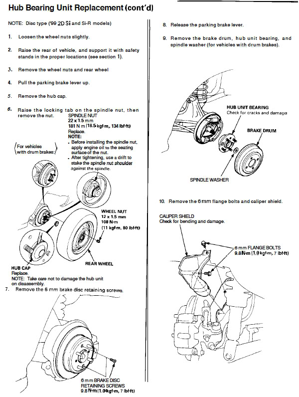

It's a job you can do at home. The OEM rear hub unit bearing assembly costs about $100 (not including shipping and handling) at Majestic Honda. Call around for comparison prices at your local auto parts stores.
