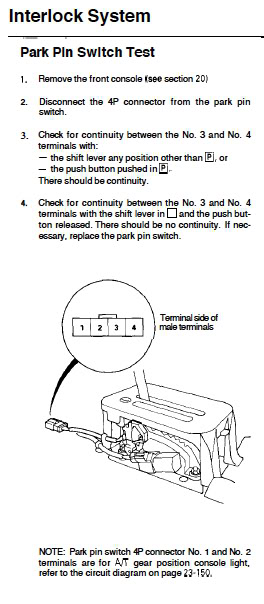

Old Jul 16, 2011 | 11:37 AM
See diagrams. Inspect and test the park pin switch and the shift lock solenoid.
Also inspect the push button mechanism:

Thanks RonJ, for the help with pictures. I'll update post with findings by next weekend.
