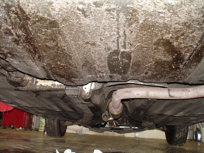

ok well after all that work to drop the nasty fuel tank turns out those lines are all good.... i dont know how..
NASTY!!!!!!!!

^ SOMEBODY WENT CRAZY WITH THE UNDERCOATING!!!!!!!
and i found the leak.... it was on the front passenger caliper brake line.... just tightened it up alittle and its not leaking anymore. bleed the brakes still no better performance from them but the ABS is kicken in better now.
the busted axle boot and grease all over the place was hiding the brake fluid mess. as soon as i cleaned off the caliper and brake line i found the leak really fast. so at least its fixed now!
