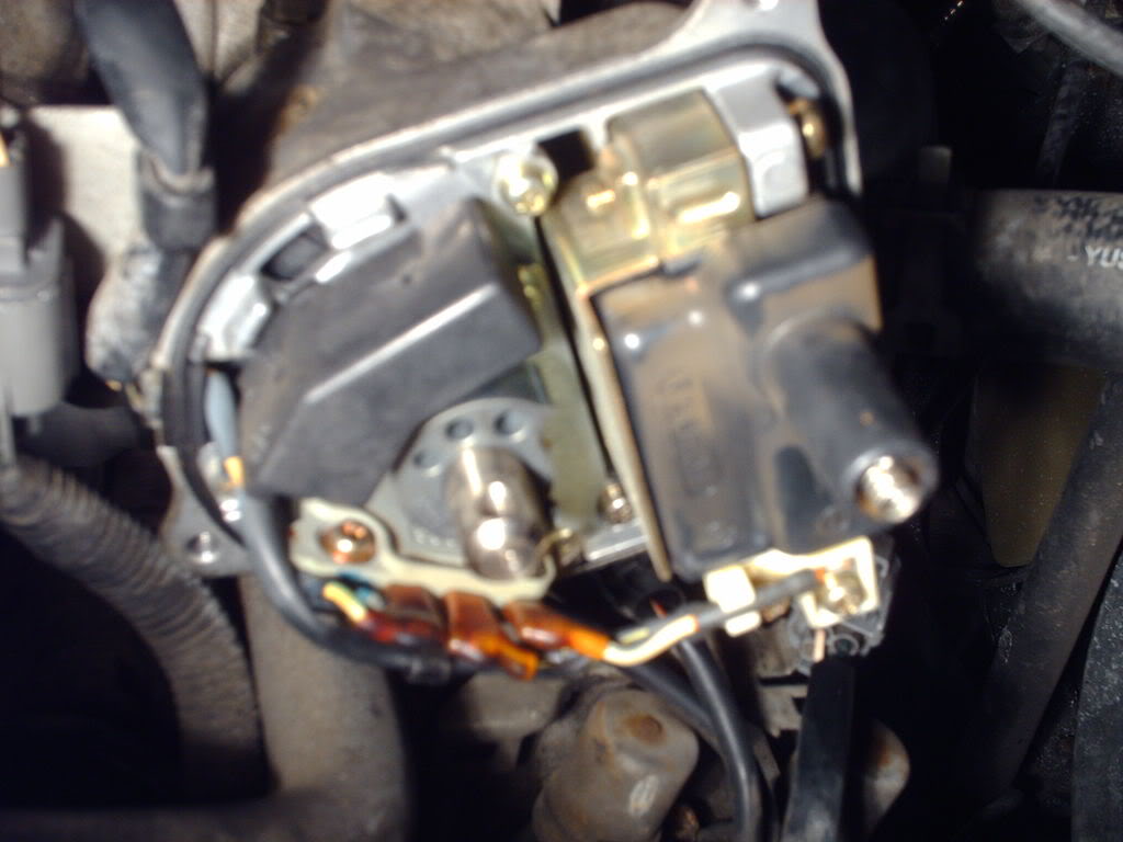

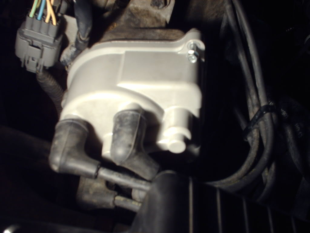

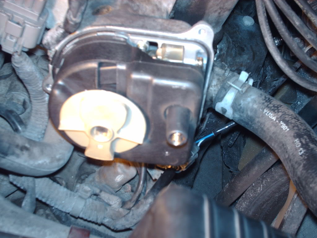

Once I got home took another look under the hood and found distributer cap was dry pulled spark plug wires and found water in the valley. dried them out pulled the plugs they looked fine. put it all back together and she fired up took her around the block and she just didnt seem like she had all the power but she was running. Pulled it into the driveway and was wondering am I misfiring. So did the dumb thing pulled the wires from the plugs to see how bad it starts misfiring went throgh all 4 and it seemed to be about the same so why not do it again. Started on the drivers side this time, pulled the wire she started running really ruff then shut off. I said ok lets just start it again. nothing wouldnt start.
So I verified I had gas yep, ck for spark, nope. pulled plug and couldnt get it to spark against the block, spark plug light, tried a different plug same thing said ok must besomething else. Read in the manual about the icm and the coil. I have all the voltages going to the ICM and according to the manual I need to replace the ICM, but I decided to check the coil and found on the primary wining .99 to 1 ohn resistance.. book says it should be .63 - .77 and on the secondary winding found about 10k ohms book says it should be 12.8k - 19.2k. checking voltages on the coil I have 12v on terminals a and b, on the secondary winding terminal I also have 12v.
This is where I am not sure my coil is a little out of spec, but one end is low and the other one is high. So can the coil be bad or is it going bad. should I replace it? and the other question is do I do what the book says and replace the ignition control module, though the book dosent really do anything to really tell me if its bad it just verifies that the out put voltages are there. So I have one of4 options to fix it.

I have seen other posts on this forum where people have blown their coil after pulling plug wires when the engine was running. In addition, your coil is not giving the correct multimeter readings. Therefore, my recommendation would be that you replace the coil.
