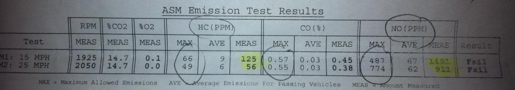

So i recently got a 1997 Honda Civic EX that somebody thought wasnt running but it ended up just needing a new ICM and ignition coil so I replaced that along with spark plugs and all the fluids in the engine were flushed. I didnt not change the spark plug wires or dizzy cap... The car has been sitting for a while so i filled it up with regular 87 octane gas after putting in a bottle of lucas fuel system cleaner because the car had been sitting for 6+ months with a 1/4 tank, part of which is probably still in there (im half way through that fill up driving around to reset the ECU). Anyway here is my first read out (this was with timing way off):

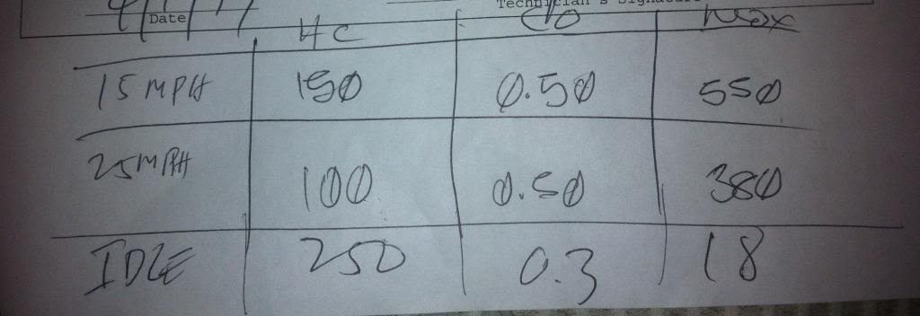

Then i replaced the air filer and drove about 75 miles to try and set the ECU, it was highway driving with a little traffic here and there. Went and got it tested again right after driving around so it was nice and hot and these are the readouts:
15mph - HC 150 - CO 0.5% - NO 550
25mph - HC 250 - CO 0.5% - NO 380
Still cannot pass. I guess I am just asking for any suggestions to help make it pass so I can get it street legal. Right now this is what I plan to do:

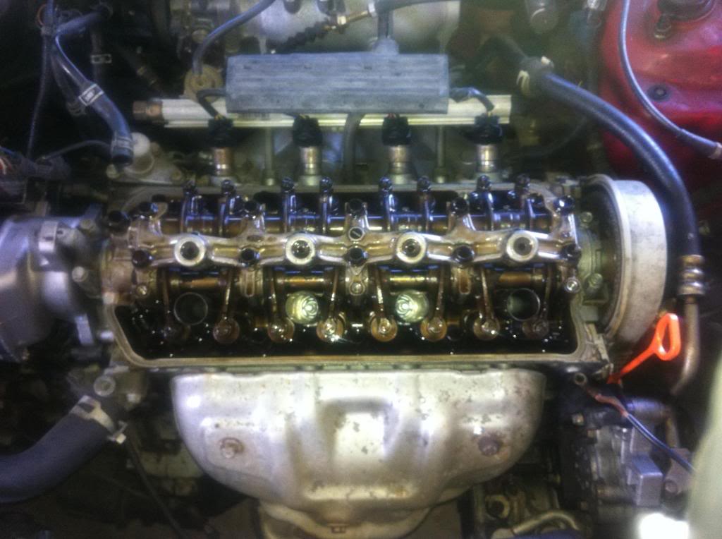

I did all the stuff I said i was going to do and the engine was running better than ever (after valve adjustment, vc gasket, spark plug seals and the valves were WAY off) then i drove around for a little, car felt a LOT better.
Then i stopped and went into a store and talked to someone outside for a little and then the car would not start back up... So i primed the fuel pump a few times and gave it a little gas and it has a VERY hard start. But it started so i took it home.
Then I cleaned the IACV and reset the ECU then adjusted the idle screw as per honda instructions. And the car was running even better BUT it started to really bubble in the overflow... Steady bubbles from the radiator and oily look in the radiator...
Headgasket, I am assuming.
Probably a bad idea at this point but i ran a little seafoam through the brake booster. The engine still ran pretty good and i drove around until there wasnt anymore smoke coming out from the tail pipe. But later that night when i drove home from my friends it overheated very quickly and the radiator started bubbling like crazy.
Anyway, I dont know if its worth trying to pass emissions with a bad HG. So hopefully someone can give me a little insight, but Im guessing Ill be taking the head off this week and replacing the HG and hopefully not need milling.
Can I use a thicker HG to make up for minor milling or is that asking for trouble?
picture of the engine...

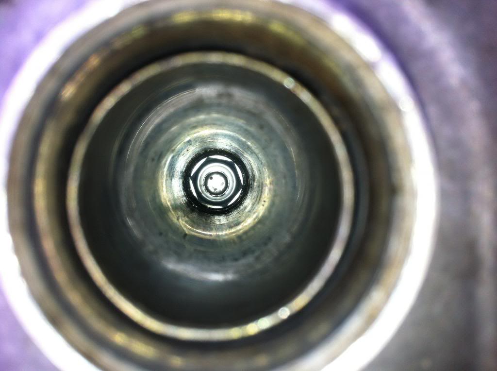

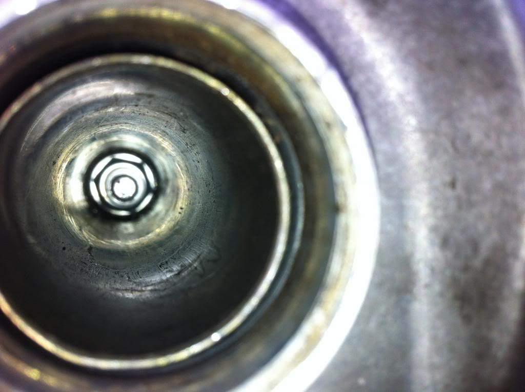

2) When I put the new spark plug seals I didnt feel like they sat right:
The spark plug tube sits in the seal when I felt like the seal should have wrapped around it, but there was no way these seals would stretch to do that...
Does that look right?

The seals are supposed to sit on the flat part between the tubes in the head and the valve cover. (not stretch over the outside). There will be some rubber inside the hole.
But it does seem the head gasket is blown. You will get misfiring with a lot of water in the cylinder. Quit driving it until the cooling problem is resolved to avoid further damage.
