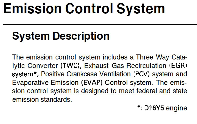

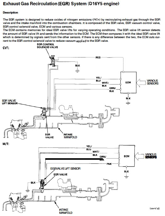

Where is the EGR system? How exactly do you check it if it is in good working order?
What engine do you have? For 96 Civics, only the D16Y5 engine apparently has an EGR system:
