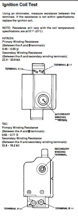

It's probably a failing coil in the distributor. Here's how to test:

Great news for my Civic. I changed the plugs and wires and the car started up. Spark looked much improved over the original orange color. I did measure the resisitance of the TEC coil as you suggested and the resistance for the primary was .9 Ohm and secondary was 16.6KOhm. I figure the coil is on its way out and new plugs/wires were just enough to give it a boost enough to start. Either way, it looks like we have found the problem. The new distributor will be here tomorow. A huge THANKS to everyone who helped out!!!
Old Oct 29, 2008 | 05:57 PM
  #24
You decided to replace the entire distributor? Your results clearly point to a bad coil, which when replaced should solve the problem for substantially less money.
