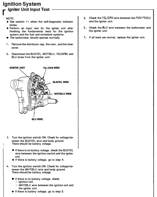

When you turn the key to ON(II), does the CEL remain ON or does it turn OFF after two seconds?
If the CEL remains ON, retrieve the CEL code(s) from the ECU as detailed at the link in my signature.
If the CEL turns OFF after two seconds, then perform the input tests described in the diagram below:
