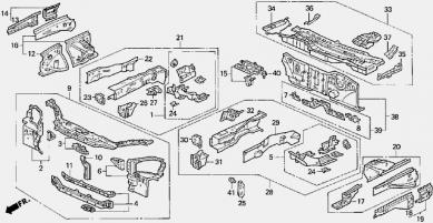

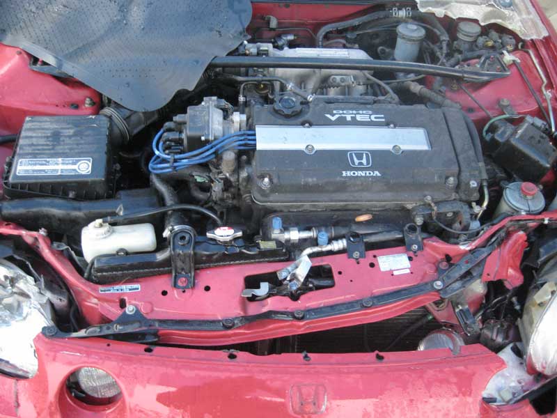

Besides the broken accessories like the passenger headlight, broken radiator, leaking power steering fluid etc ... the major damage is on the front bulkhead member that is shown on thefirst picture after i took the car apart. They are the parts on the drawing on the last picture.
On the drawing for these parts it shows that they are separate parts when in reality the parts listed as 3, 10, 6, and 2 on the drawing seem to be rivetted or welded with small circles as an entire assembly. Does anyone know how these can be replaced? Or if this whole section has to be removed? Can anyone provide pictures on how they removed them. Thanks!

The entire radiator core support comes out. Pretty much the whole metal front thing from fender to fender comes out. You have to drill out those tack welds to remove that piece, then weld a new one back on once the rest of the damage is straightened out.
Addiction2bass is the one to talk to on this one. Lets see if he pops in here.
[edit]
And you know, I think its been hit before. Half of that core support isn't painted.

well just because the bottom is painted black doesnt mean its been wrecked before...
IMO it looks better with it painted black behind any grill opening
ive done it to several old vechiles.
but ya thats not a bad hit... it was high so thats defiantly in your favor!
a simple front support, headlights, bumper cover,brace,foam, posibly radiator and ac condensor and MAYBE ac lines if they are cracked.... if your lucky they are just bent and you can slowly and carefully bend them back, but most likely the condenser is cracked since they are pretty fragile.

but if you have a drill or preferably air chisel gun you can drill or chisel and split out the spot welds on the core support. and before you cut out the core support then WAIT till you get your new core support!!!!!!! that way you know exactly where to cut out drill/chisel. i was unsure when i did mine.
also you need a drill, and a hammer and dolly would be best BUT you can use a simple piece of wood and smooth hammer head which will work just as good but might be harder in tight spots.
you will have to bend some metal flanges back no matter how you remove the damaged core support!
