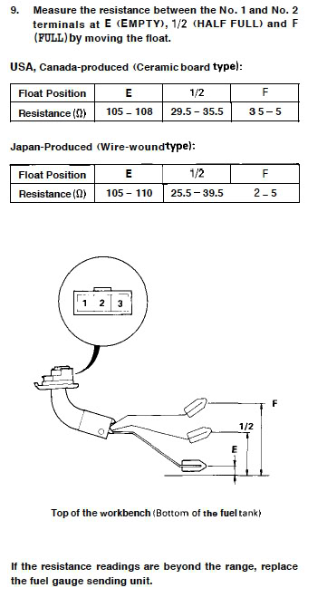

Troubleshoot the fuel sending unit above the gas tank below the rear seats.
