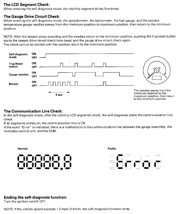

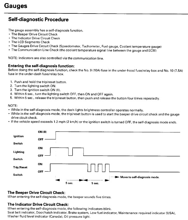

My guess is a faulty gauge assembly. Run a self diagnosis:

use the self diagnosis system. It will find out the error.
