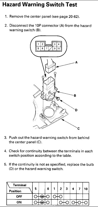

Hey guys,
So, the problem I am having is with my hazards. They don't turn on. I hit the button, and nothing. Every other light works, including turn signals, brake light, etc... Anyone has any clues as to what i should do to fix it? let a brotha know!
Thanks in advance.
Old Sep 9, 2008 | 08:09 AM
If you are sure all of the turn signals work, then I would test the hazard light switch:
