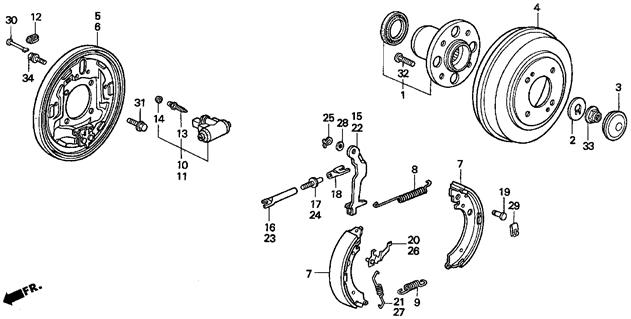

I don't see/know of any gasket on a rear drum set up. Unless you punctured the rubber seal at one end of the wheel cylinder? If so you will probably be leaking brake fluid onto the shoes which will ruin them. It would be cheaper to purchase a wheel cylinder rebuild kit from a parts store to get a new seal, otherwise you will have to buy a new wheel cylinder.
