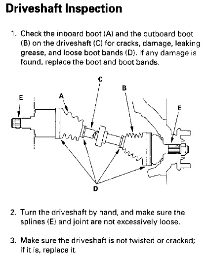

Often a knocking sound when turning signifies a bad CV axle. Start by inspecting the inner and outer boots. If they are torn, it is a sure sign they need to be replaced.
