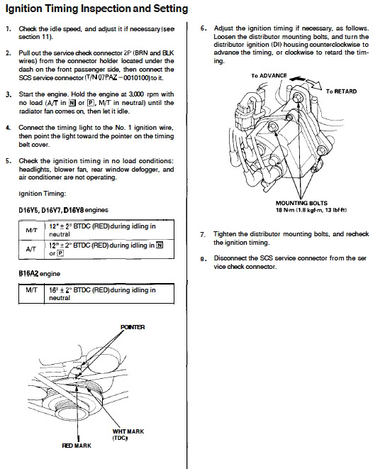

1) Check the ignition timing with a timing gun. Has the timing belt been replaced?

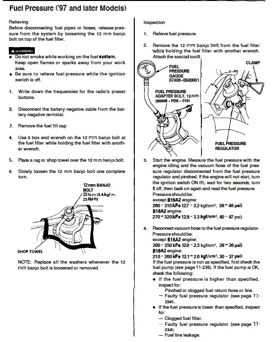

2) Measure the fuel pressure. Has the fuel filter been replaced?

1. Timing is perfect. Verified with timing light per your procedure.
2. Guess i will order a banjo bolt with 1/8 npt port and attach a fuel pressure gauge (available from summit racing) that will permantly reside on the fuel filter. I'll hook it up where the above mentioned test guage goes. Probably easier than finding the test gauge.
