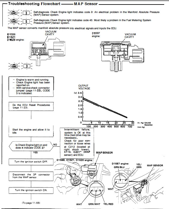

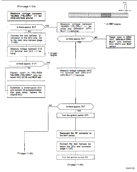

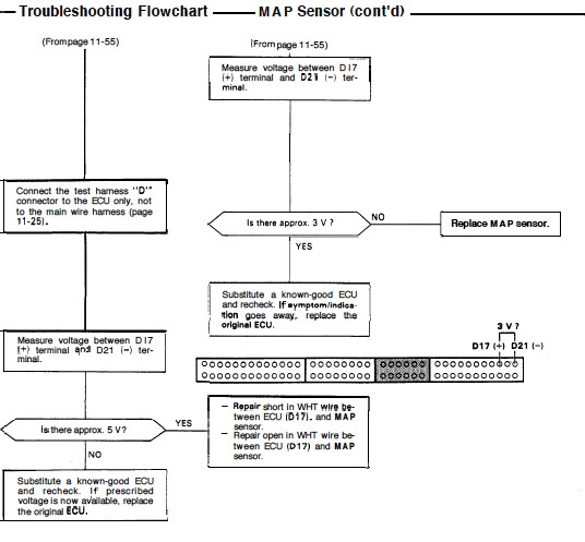

  #32
Originally Posted by mk378
There should be voltage on the center wire of the MAP I think. One of the outside ones is the ground. You should have zero volts, 5 volts, and something in between respectively from each of the three wires to ground.
We differ on which terminals of the MAP sensor connector should be hot versus ground. My recommendations were based on information in the 92 Civic service manual, which I interpreted as indicating that the two outer terminals of the 3P MAP sensor connector are hot while the middle terminal is ground (see see voltage tests in diagrams below).
Is my interpretation of these tests wrong? Is the 95 Civic MAP sensor different for the 92 Civic? Is 95HonCivic's reading of voltage at the middle terminal expected or does it indicate a problem?
