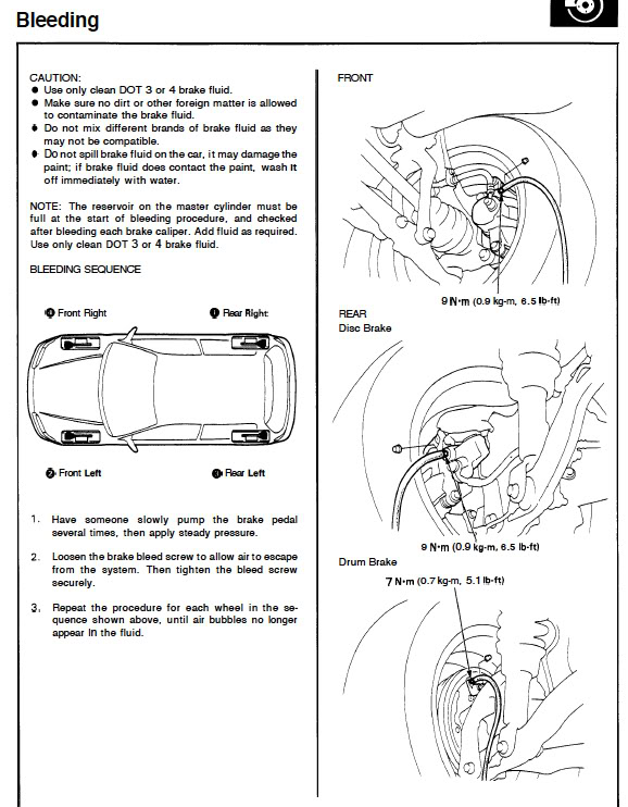

Did you lose fluid through the wheel cylinder while disassembling and reassembling the rear brakes. If so, some air may have entered the system. Below shows how to bleed the system. Here is the bleed tool that I use.

These comments are an even stronger reason to follow the instructions in the diagram.
