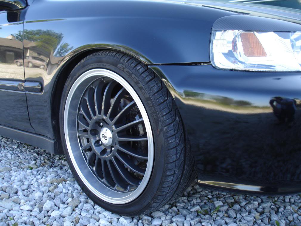

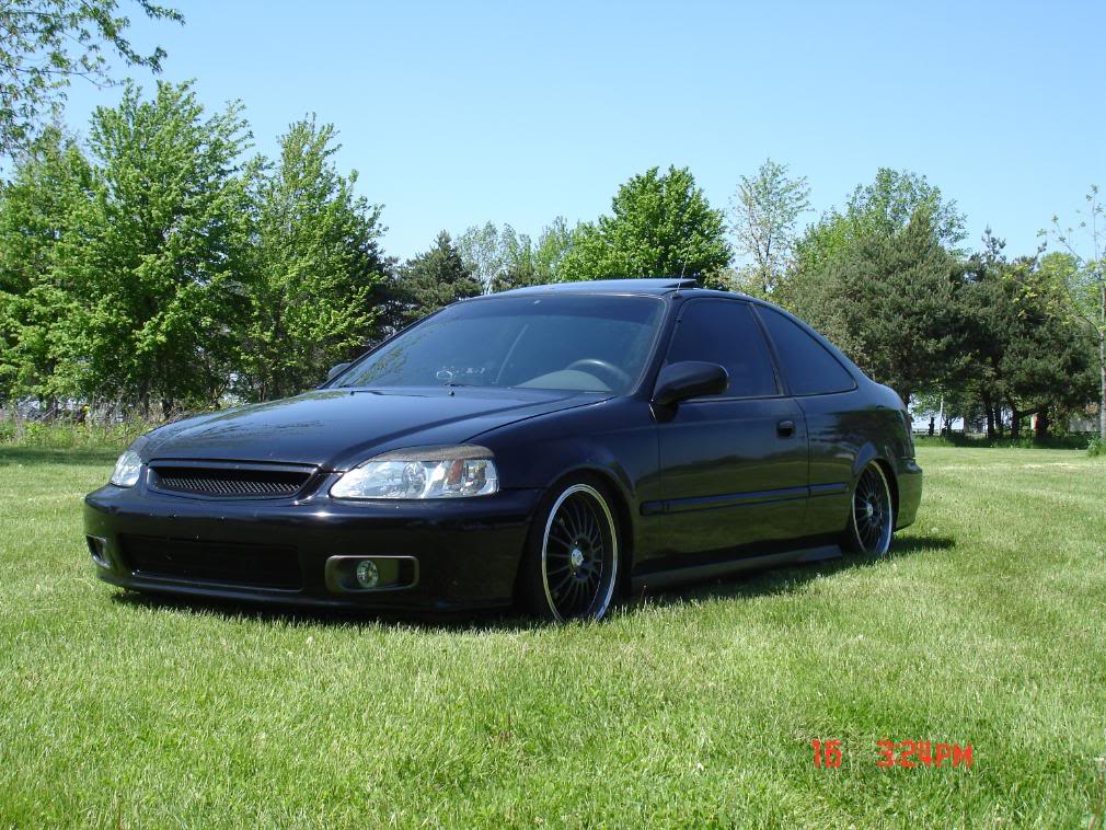

i liked those springs to a extent... they will sag alittle more once they settle in... which is why you need to wait afew weeks to get a alignment...
they ride nice but as you already know they are just drop springs what you see is what you get.... and if you have attention to detail much youll notice the rear is not a even drop just like any drop springs you can to use.
which is the main reason i ditched the Stechs and went with koni yellow struts and ground control coilovers.
they give you a killer drop as well as adjustable struts and also adjustable height/drop that you can dial in to your liking!!!!!!!!!! and i loved it that way! i had both sides matching height, had front struts set almost full stiff and the rear struts were set soft which rode great for the slammed look. of course its not gonna ride as nice as the Stech or stock springs but the adjustability of everything was well worth the extra cash IMO. expect to pay about 1K or so on the struts and springs depending if you also get adjustable camber arms for front and rear as well....

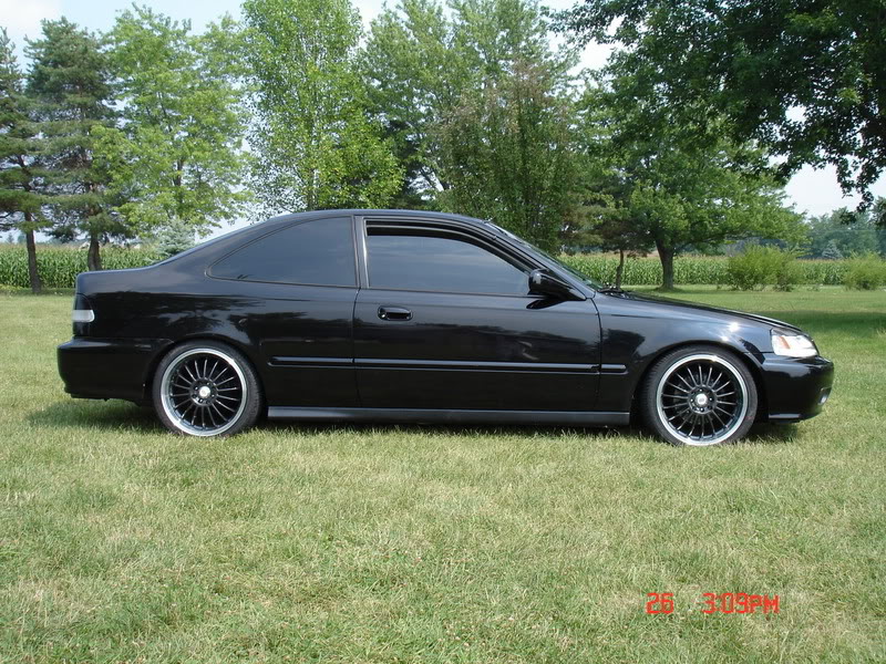

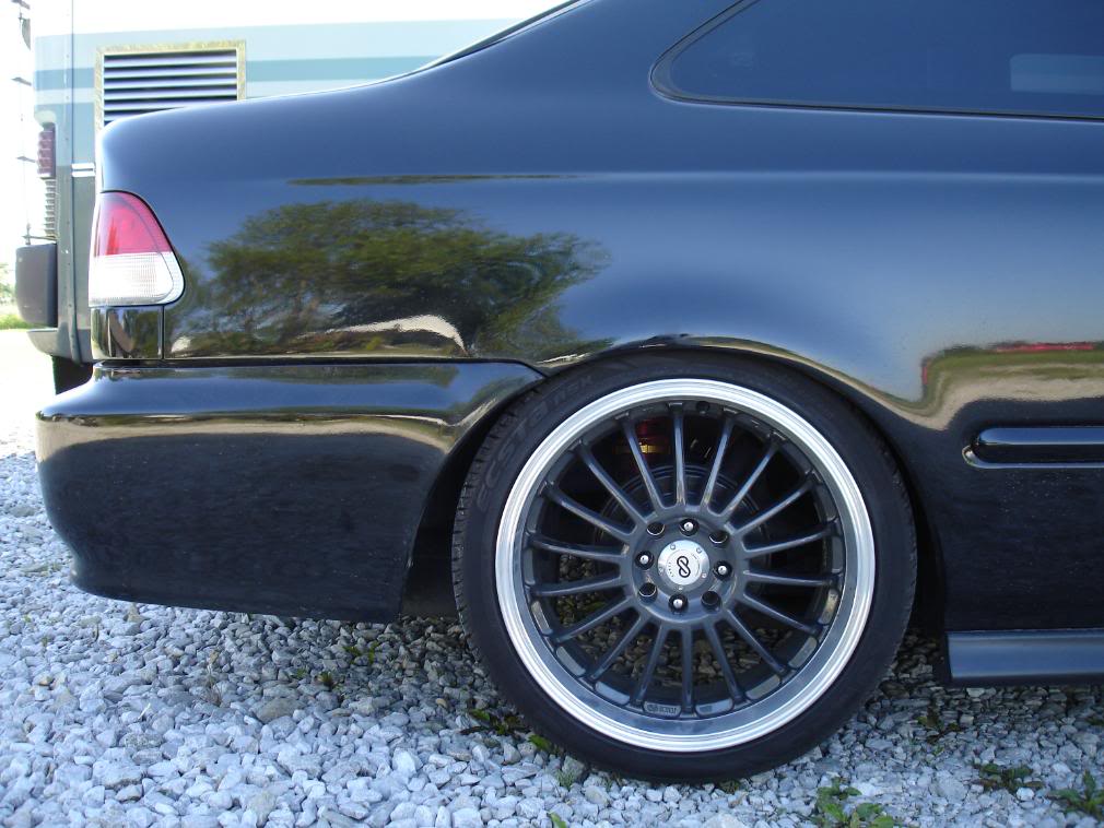

o i miss the old girl..... if only it was a manual id still have it. i had that thing lookin sweet!
this was my daily driving height i set it at. still low and drivable. with any lower then the front rubbing would be a issue with turning

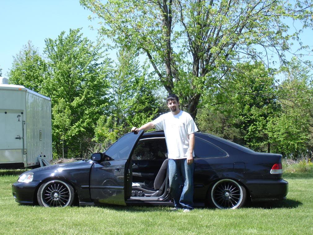

not sure about thepics... i think thisis with the stechs

Had quite a history with ur civic lol. looks nice btw. and the stechs looks like a pretty descent drop. hopefully i wont be plowing the roads during the winter. cuz this is going to be my daily car until next year =/. so hopefully it goes good through this one winter.
