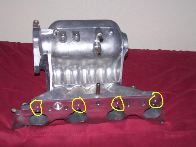

99-00 D16y8 Intake Manifold not working with your 96-98 D16y8 Head? (or vise versa?) Here is why...
I found out the hard way, during my motor swap, that 96-98 IMs are NOT the same as 99-00. They appear to be in almost every aspect, but they ARE different.
The 99-00 Manifolds have an extra air injection system built into them, with these tiny little ports that WILL leak air and cause ridiculous idle surge if you try to attach it to anything other than an OBD2b head.
Here is a pic of the air injection holes.
I ended up bringing mine to a local welding shop and having them seal up the holes. Took em 15 minutes and I was back in business, idle surge free, shortly after.
