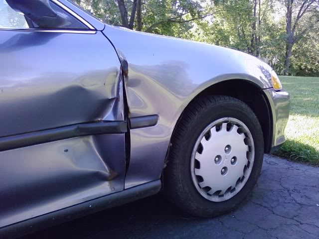

Ok, I've some body damage to my car. The three big things I'm shower; civic cancer, a smashed in door and a nastily cracked windshield.
I inherited the car from my step-bro...the bent in door...yeah, his mom hit it while pulling into their driveway years ago. He was too lazy to get it fixed.

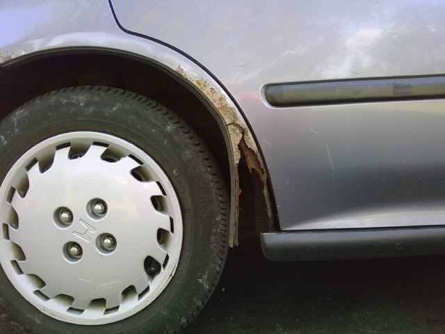

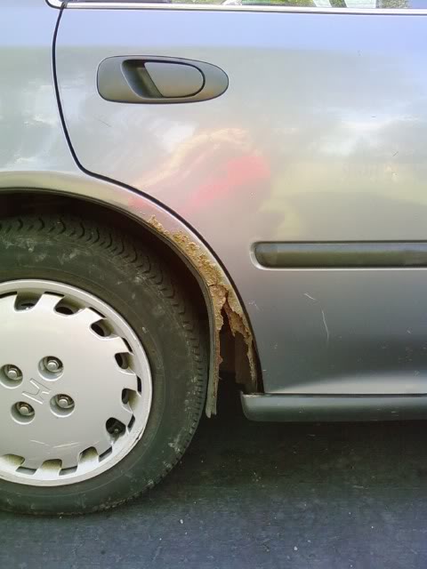

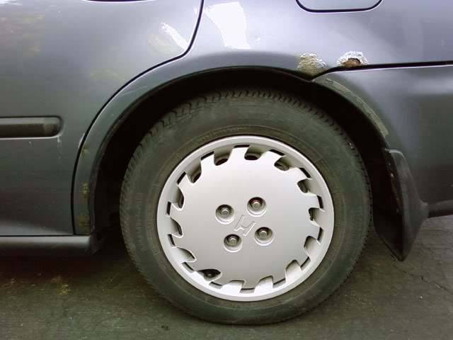

The civic rust...self explanatory. I've heard bondo? Cut it all off then bondo it? No idea.

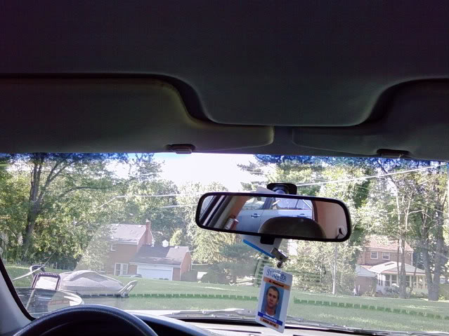

The windshield...Same step-bro...driving through a taco-bell drive through during the winter, an icecicle fell and supposedly cracked his windshield (right before I got the car). Naturally he also did nothing about that. I understand it's a huge risk to have. Here are my pics, advice on how to fix, the things, where to fix them, prices, whatever would be helpful.

For the windshield, I've been recommended to go to SafeLite or whatever.

The door and fender are easily replaced if you can a find a donor car. The rust will come back not unless you cut it out and weld in new metal - not cheap unless you known someone you can weld in new metal. If you are just using the car for transportation, I would replace the windshield and drive the car until the wheels fall off. At least you got the car for free.

I agree with the previous poster regarding cut/weld for permanent rust repair. Even then you have to coat the underside, prep the metal, and sandblast the welds or you will have bubbling later. If you google 'bondo rust repair video' you will see some good clips that can help you in making your car much more presentable as you drive it. Not only that, it can be fun (and frustrating at the same time). I used to live in NE Ohio, so I feel your pain.

Its natural to want to fix a car up when you get it. What you're talking about, however, will cost you more to fix than the car is really even worth. The rust you're seeing is maybe 50% of what's actually there, much more is behind the metal and under the paint, so if you wanted that job right there would be a lot of metal getting replaced. Door and fender, even from a junk yard will be somewhat expensive, then you have to make sure they're shimmed in just right. When its all said and done, unless you're pretty lucky, you'll have a nice looking fender and door that are the wrong color. Get them sprayed you're talking about more bux.
I agree with the above, get a windshield and call it good. I would get a saws-all or similar and cut off that piece of metal that looks to be ready to pwn your tire in the right quarter. THere are some compounds that neutralize rust, you could go to an autobody supply house and pick up some of that if you want to slow down the progression of the cancer. Make sure you grind off all the paint around the area and get behind the metal as much as possible.

yeah i think you got the best info, just rock it till the wheels fall off. most of the rust is inside so your looking at alot of cutting, welding, grinding, and paint matching. just fix the window and ur good to go.
