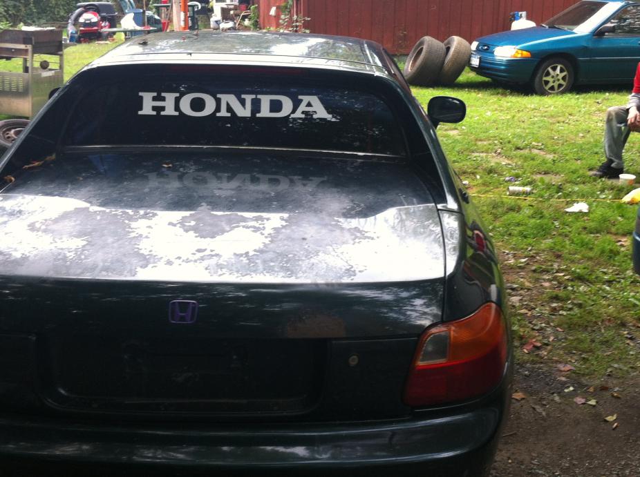

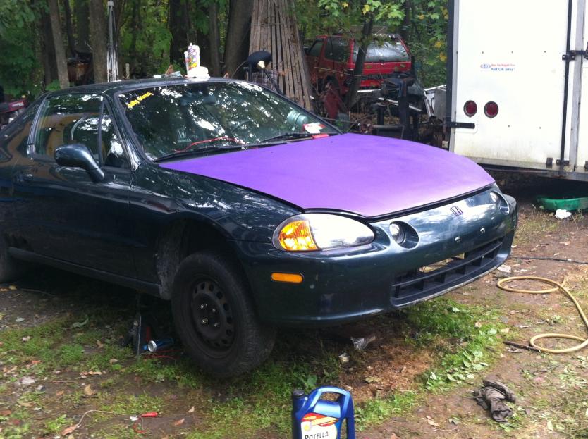

,updated!!, she will be ready to be turned over at 2:00 today i got some pics
Attached Thumbnails somebody please help me-photo-28-.jpg   somebody please help me-photo-29-.jpg

well i found out why my fan wasn't turning on when i did my motor swap i never hooked the ground back up to the fan
