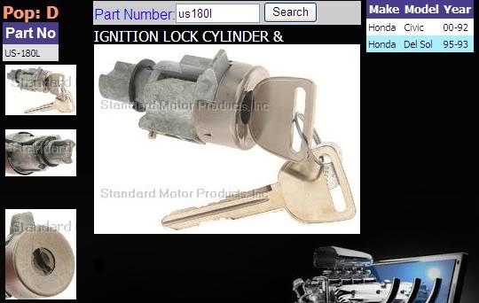

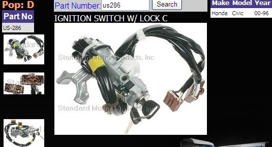

The price I quoted in previuos post was for the lock cylinder with wiring
I also offer just the lock cylinder for $58.88 plus shipping
