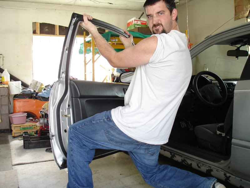

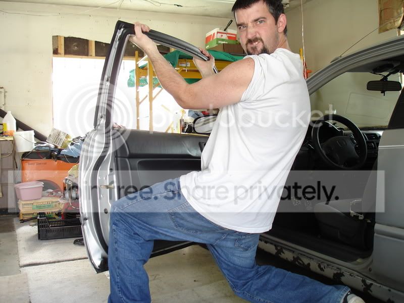

muscle up sucka..... just pull. well as long as your door seals are not torn up it will work.
my only problem with my 96dx is the windows themselves on top. i dont know how to fix that.... i just push really hard on the window cranks

best picture ever!!!!

it works it really does!
you might be able to try to adjust the hinges BUT if your door is straight from the fender and rear quarter than thats not the problem. the only problem is the top door frame is slightly bent outwards. very common for years and years of normal wear and tear from opening and closing the doors.
if your cars had the keys locked in the car before it tends to make it worse since they wedge a plastic piece between the door and body to get there rod thru the door to get in. or if someone tries to break into your car the same way... it just makes it worse.
Haha! So EPIC!
