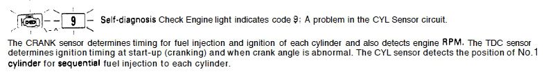

Nice pictures. You seem to have the mechanical timing set correctly, so I agree that purchasing a new dizzy assembly is the logical next course of action. I guess a bad CYL sensor is preventing the ECU from properly seeing the position of cylinder 1 and thereby throwing the timing off:
