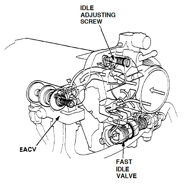

someone told me it could be my IAC? dont know what that is
Old Jun 29, 2008 | 06:55 AM
Default RE: what my problem?
ORIGINAL: hamorhead
Yes. The IACV (=EACV) is on the throttle body and controls engine idle speed under various conditions. You could try cleaning it with carburetor cleaner (see forum DIY section).
