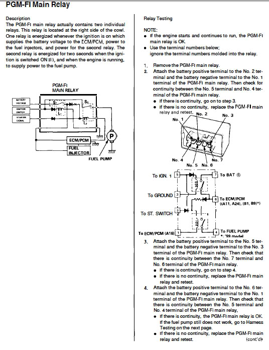

I do not see an obvious connection between the ELD CEL code and fuse 44 blowing. For the ELD code, check whether fuse 15 is blown. If so, mention in your next post.
Regarding the fact that fuse 44 continually blows, you may have an electrical short in the main relay itself. Remove the main relay and do the tests in the diagram below. If the main relay tests fine, then do the series of electrical tests on the main relay circuit described in the 96-00 Civic service manual, beginning on page 11-238. Had you been having any electrical problems prior to the no-start that led to this thread?

main relay is fine and even tried replacing it with another main relay that i had as a spare. ELD has also been replaced with a spare that is fine. fuse that you asked me to check (fuse 15) is fine as well. the only fuse that blows is the FI E/M fuse under the hood. it blows the second the ignition goes to the on position. do you know of any place i can get that manual...i tried to dl from the lnik you provide but cant seem to open it...
