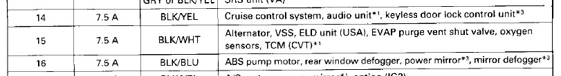

fuse 15 is fine
Is the dash charge light ON?
Note that most of your CEL codes are for functions protected by fuse 15 (VSS controls the speedometer; you previously had the ELD code, and codes 41 and 65 are for both O2 sensors).
You may want to read this service bulletin:
http://www.tegger.com/hondafaq/tsb/civic/x99-029e.pdf
