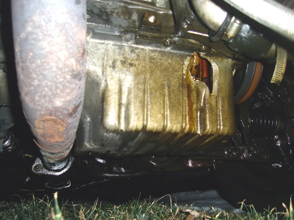

Hey new Honda guy wants to know why you would have upgraded your oil pump before turbo?
Old Feb 1, 2007 | 01:05 PM
INJENalltheway's Avatar
Joined: Nov 2004
Posts: 1,396
Default RE: D16Y8 Turbo
Or this will happen!

So what should I do? Get an old one and do some mods?? I though I saw a post here about opening up some of the flow holes er sumpin like that.

Old Feb 12, 2007 | 12:10 PM
ORIGINAL: marspark
Ideally, get a new oil pump, mod it according to the link I posted on page 1, and swap it into the motor.
