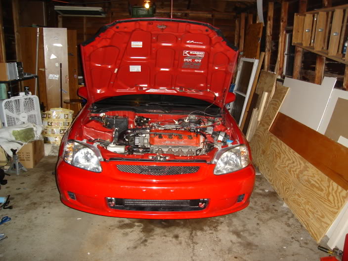

Do I need to get a custom bumper so the IC gets enough air over it? I would really rather not, especially to keep it more of a sleeper. And I was planning on going with a smaller IC rather than one of the giant ones.
Old Jun 1, 2007 | 09:35 AM
Default RE: T25 build
no custom bumper needed, just a little creative cutting of your stocker...
