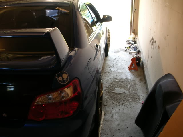

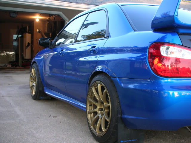

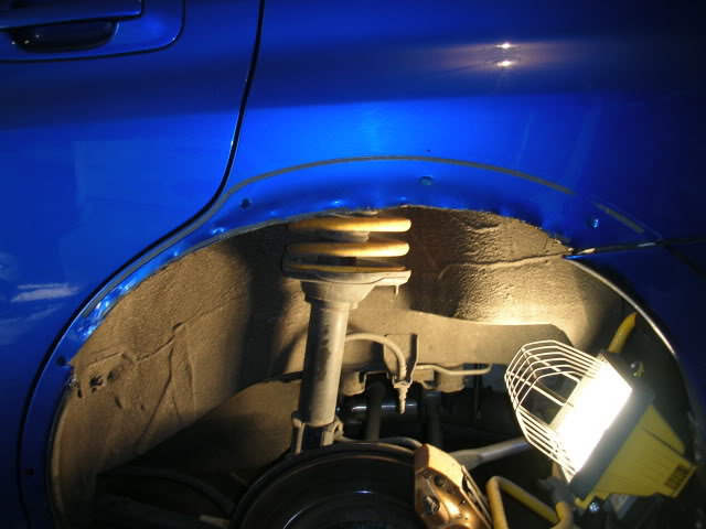

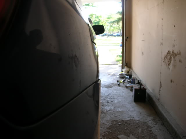

Well I don't know if anyone knows this or not but the 2005 STi rear fenders are already rolled. I picked up some 18x9 Rota G-Forces with a +30 offset. Well to make a 9" wheel fit you need to go with a 40-45 offset. WHOOPS! So I decided to take matters into my own hands. Got out the grinder to grind some of the inner fender off and to loosen up the spot welds then spent all night hammering the fenders off.
I still need to put some Fusor 803 inbetween the two panels to replace the spot welds and get some no rust paint to put on the inside of the fender. The fender flare will go back on with Fusor 803 and some clamps.
Here are pics:

Look at the massage the fenders got
I think I am going to hammer the fenders out a little more on Thursday when I get the Fusor in.
