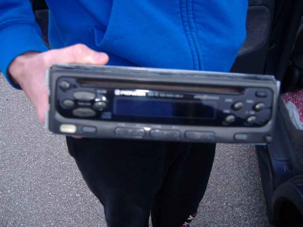

Here are some pictures of my head unit. I hope I did this all correctly. Took me a while.
Head Unit Front: Pioneer DEH-42 Super Tuner III

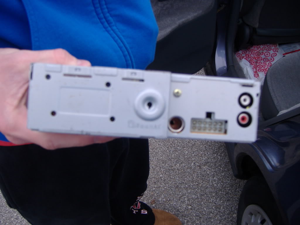

Back of radio.

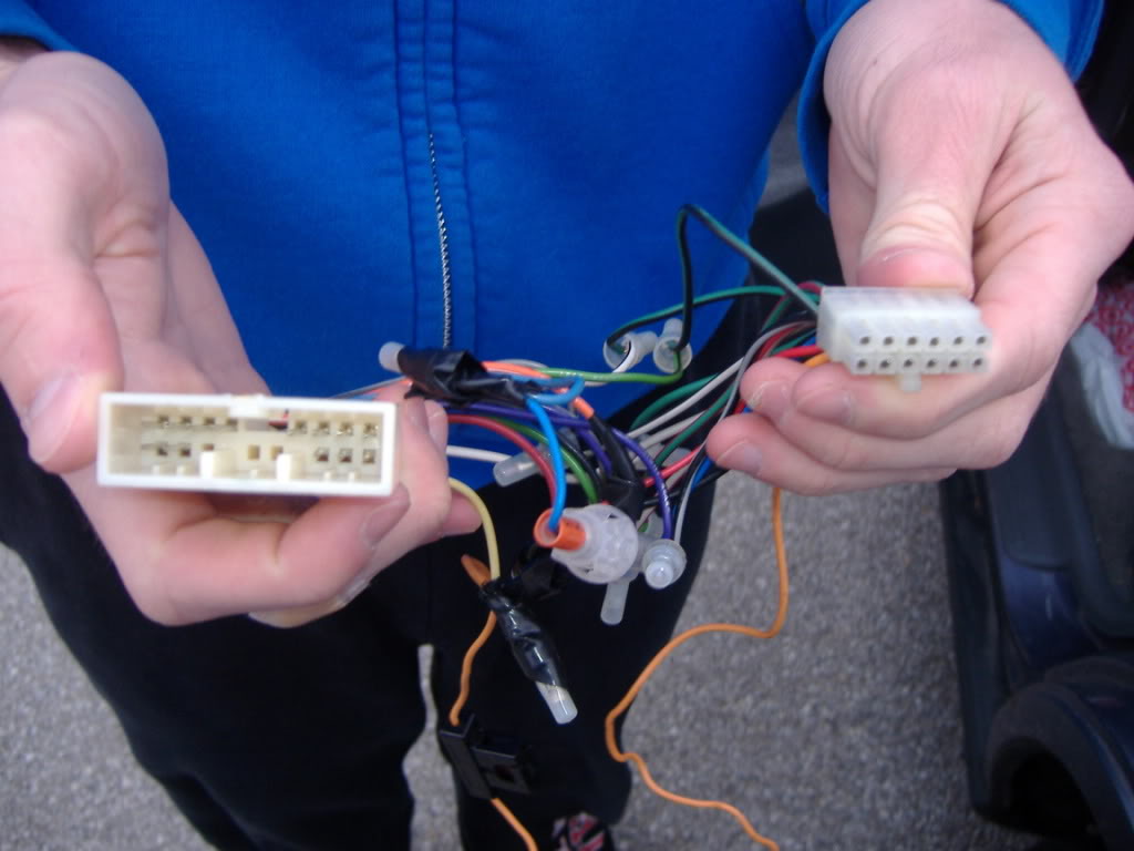

Terminals. Left goes to the car, right goes to the radio. Wires are all spliced correctly and clamped fine.

thats definitely the old style Pioneer plug, so whatever radio you decide to get you will have to redo the wiring harness for the new plug from the new radio. and I would recommend putting zip ties around the wires when you are done so that theres no random wires hanging all over the place. I'm sure you can get new crimp caps at an auto parts or a home improvement store.
Its going to be extremely hard to find that exact radio, and even if you do, its so old that I dont recommend it at all because you will probably have problems with it too. I would just go out and get you a brand new radio. Pioneer makes a couple that retail around $100 (DEH-2000MP or DEH-3000IB), and are just basic radios that will be very reliable. Another personal favorite is Alpine, and their lowest radio (CDE-9874) retails at $150, so you will pay a little more, and its only a 45x4 while the Pioneer is 50x4. Also these are just retail prices and you can probably find them all cheaper somewhere

For the wiring harness of a new radio, I have a bigger terminal (the female side of the larger one in the picture), that would still work for the new radio, right? I'd just have a new set of wires I'd have to splice and crimp?

Yes you will re-use the bigger female plug (the side that plugs into the car). That piece works no matter what radio you have. When you get a new radio it will come with a male harness that plugs into the radio. All you have to do is match up the wire colors on the two harnesses and crimp them together.
