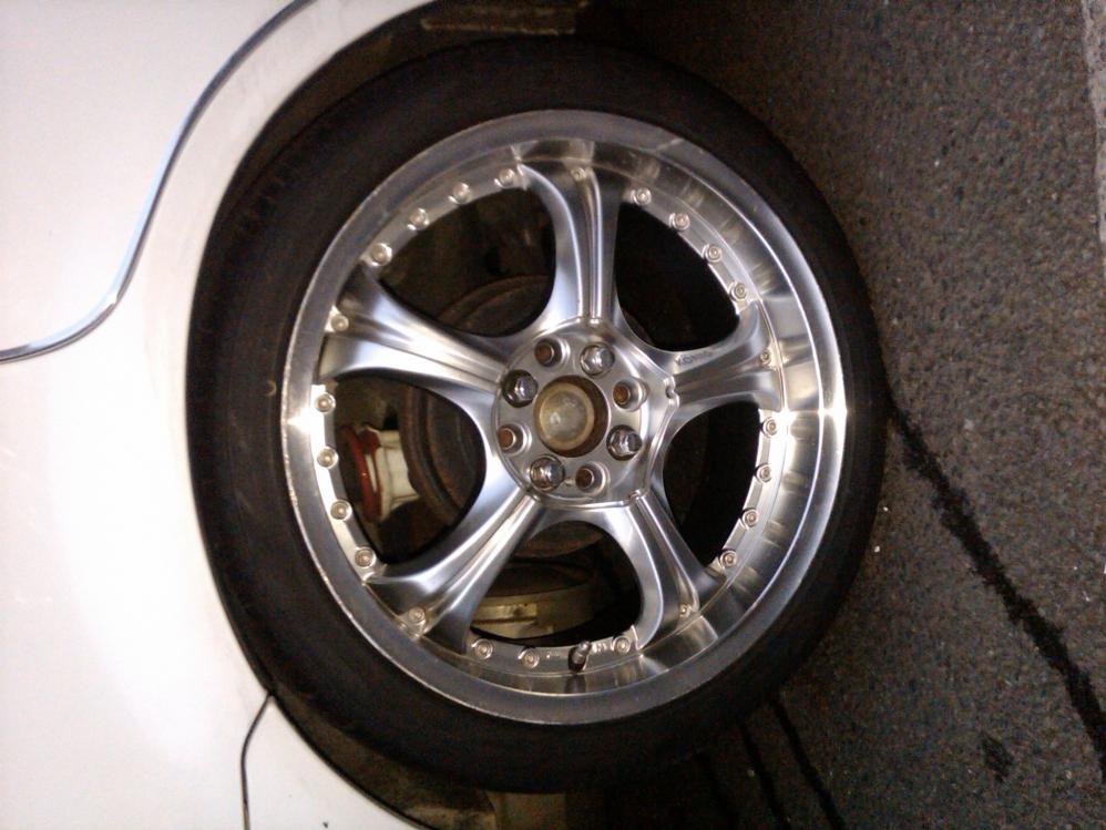

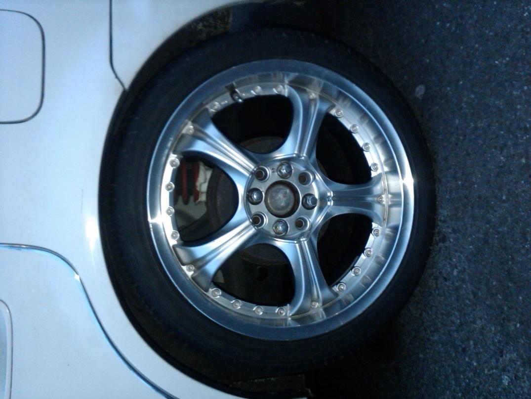

i just put some 17" Konig rims with 205/45/17 tires on my 4door civic (96) yesterday and they rub..my car previous to this was already lowerd 1.5 inches all around..i was wondering what are my options to get rid of this problem. i spoke with a mechanice yesterday and he told me to bring it by, that he was going to get rid of that problem. but he didnt tell me what he was gonna do..so im jus wondering what my options are before anything happens..

1) Get 205/40-17 tires; your 45's are too tall.
2) Rolling the fender lips should help
3) I'm going to say it's a mix of too-tall sidewalls and you wheel offsets. With a 205 treadwidth, you want a +42 to +45mm offset. Even if your offset is close (+40mm), you'll probably have some slight rubbing problems.
Also, is the camber corrected on the car since it's been lowered? If it has been, that could also be part of the problem. Zeroed-out camber might look cleaner (personally, I like a bit of negative camber), but if you're low enough, it can potentially cause rubbing problems.

here they are
Attached Thumbnails 17" tires RUBBING-img00352-20090413-1932.jpg   17" tires RUBBING-img00356-20090413-1934.jpg

I'm not trying to be a douche or anything, but you're dead wrong on the 45 being a lower profile than a 40. 40% of 205 is 82mm or 3.22 in. 45% of 205 is 92.25mm or 3.63 in. The higher profile is why 205/45's are more comfortable over potholes; more sidewall to deflect when the tire hits a bump/pothole/etc.
And the negative camber helping is what I was getting at. Trust me, saying I know a lot about tire sizes, wheel dimensions, suspensions systems, and suspension setups is an understatement.
