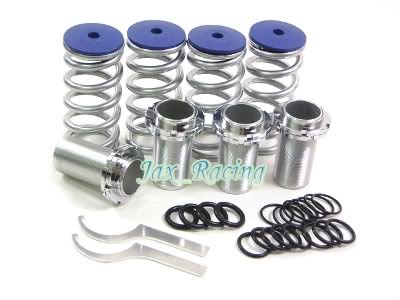

hey i got some coilovers from ebay the cheap ones just 4 now but im trying to install them myself but i been wondering whats up with the plastic rings and the metal ones??? where do they go can someone post some pics

Is this something along the lines of what you're dealing with?
If it is, you put two of the rubber o-rings on each shock (I'm not sure what size o-ring to use), and put one of the threaded sleeves over the o-rings (they should be tight) with the threaded portion on top. Then, put the springs on the perch that the threaded sleeves form, and re-assemble everything else like stock (you'll probably want to cut your dust sheilds and possibly your bump stops.)

What's the blue plastic cap for? A lot of ebay coilovers look nice but turn me off with that plastic part!
