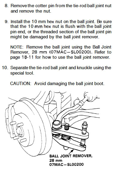

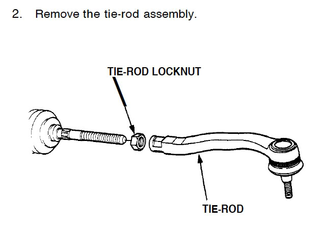

I think you first pop the outer tie rod ball joint, loosen the lock nut on the inner tie rod, and then remove the tie rod. Spraying some penetrating oil on the inner tie rod side would also probably help with the removal.
