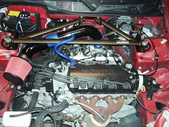

Anyway, I don't have any hands-on experience with the 3-points (my old civic had a 2-point that I bought before actually researching my mods), so I can't say for sure how they bolt on. I think you have to remove the wiper cowl and bolt through the firewall, but I'm not 100% sure on that.
Looking at this picture, I'd say it's what you have to do, though:
