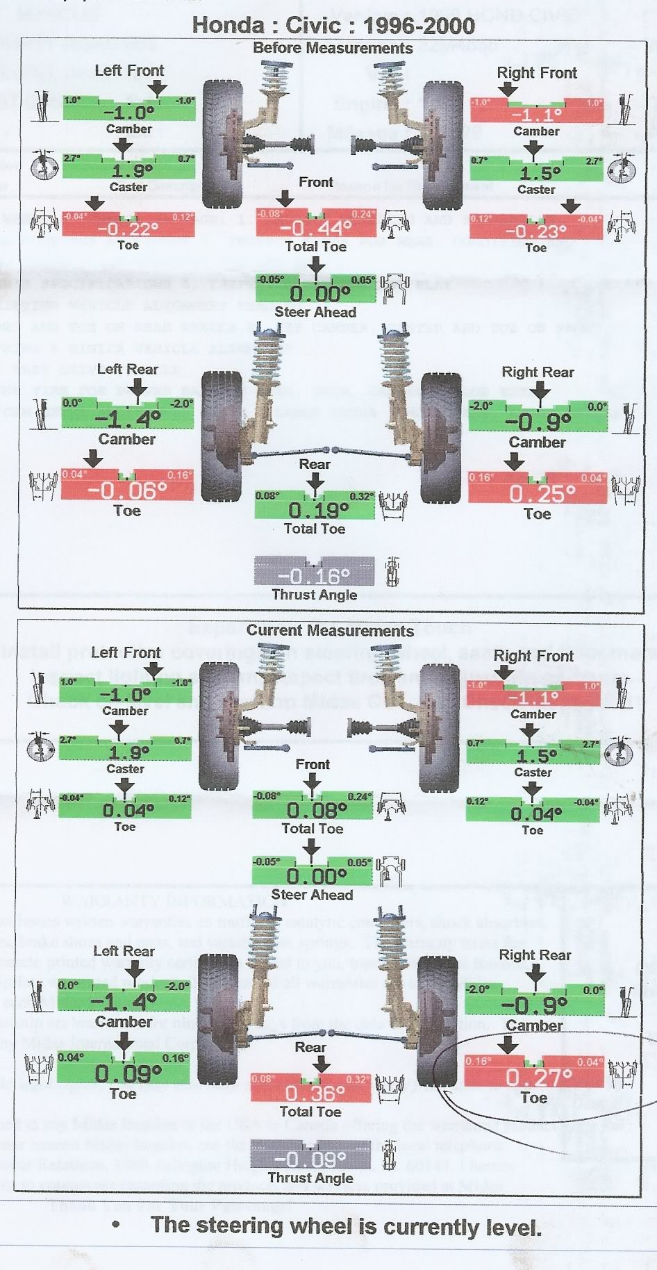

heres a picture of my alignment sheet from my 99 with Stecs. BEFORE and after alignment. and yes one rear toe adjuster was siezed on the bushing. i fixed it and just eyeballed the toe... tho i did ALREADY have the 3washers on each bolt of that rear upper arm kinda odd how one side different so ill try taking out 1 washer on each bolt on that side next spring when i get the 99back on the road. but i wont be driving it much this year and as soon as it snows its geting storage insurance and parked till spring... but im not to worried about it. toe is the major killer of tires.
