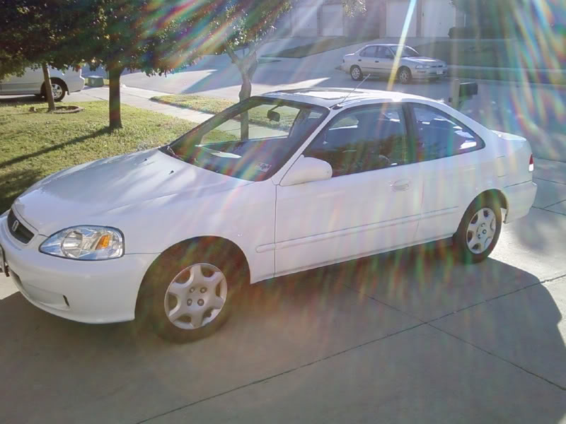

So I had a both most of saturday and all day sunday off of work so I decided that this weekend would be a good time to swap over the suspension. I work at Best Buy and the fact that its christmas season theres not telling when I will have that much time off over a weekend again. For those of you who don't remember, I put a whole new suspension on the hatch about 3 months ago so all the stuff is practically new.
Stuff:
Eibach Sportline springs
KYB AGX shocks
Skunk2 Pro Series + front camber kit
Skunk2 rear camber kit
Energy Suspension Urethane bushing kit
Well I got it all in and everything went pretty smoothly except when I went to replace the rear trailing arm bushings. This was the first time I have ever replaced any trailing arm bushings, and these things are a PAIN IN THE A**. I refuse to ever do it again. I spent a good 3 or 4 hours just getting all the factory rubber out of the shell. It was ridiculous.
But its all done now and I went and got it aligned when I got out of school. Rides really nice now, and it feels so much better now that I am back to being close to the ground
So here are some pics, first is before and after, then pics form during the install.
before
and after
after again
and heres the amount of space I was working in most of the time
and the space I was working in when I did the driver side of the hatch
and just another pic
