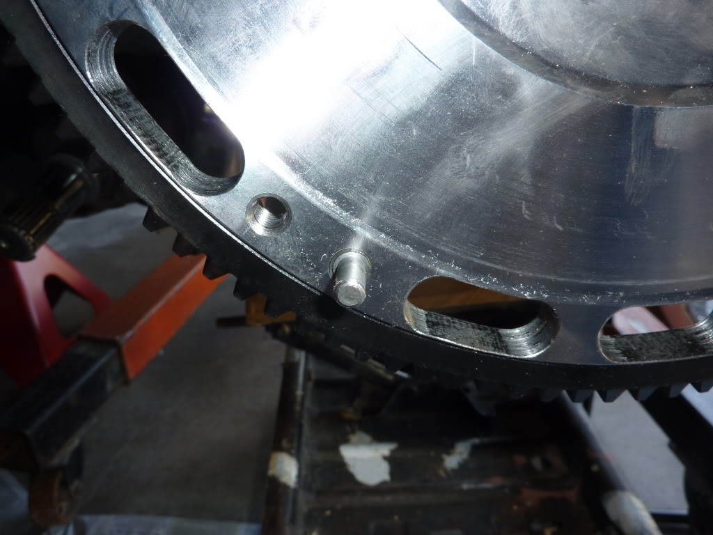

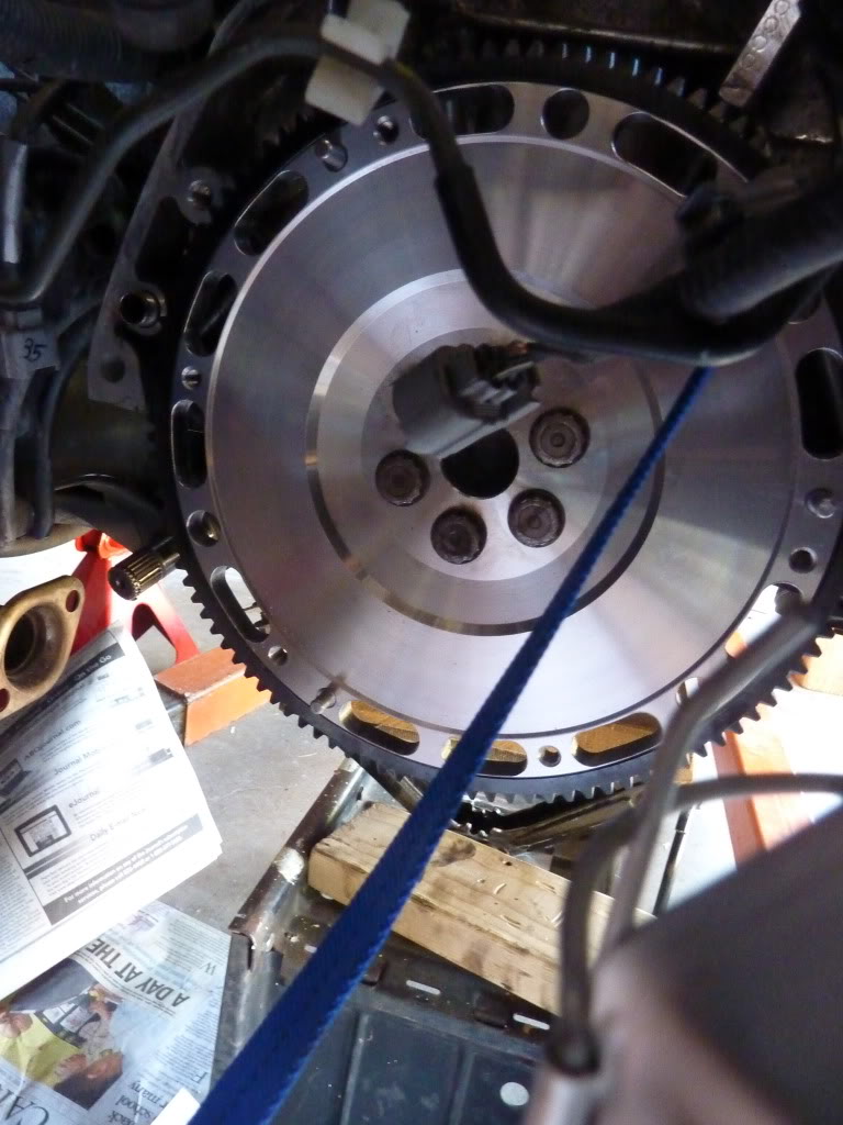

So I ran into a bit of a problem....
There are pegs that come out of the new XTD flywheel that are too big for the Exedy OEM clutch/presssure plate. On the old flywheel, the pegs look like they were cut off or somehow were made to sit flush with the flywheel surface. The screw holes on the pressure plate line up on the old and new FWs
Piczors
new flywheel
one of the pegs I'm talking about

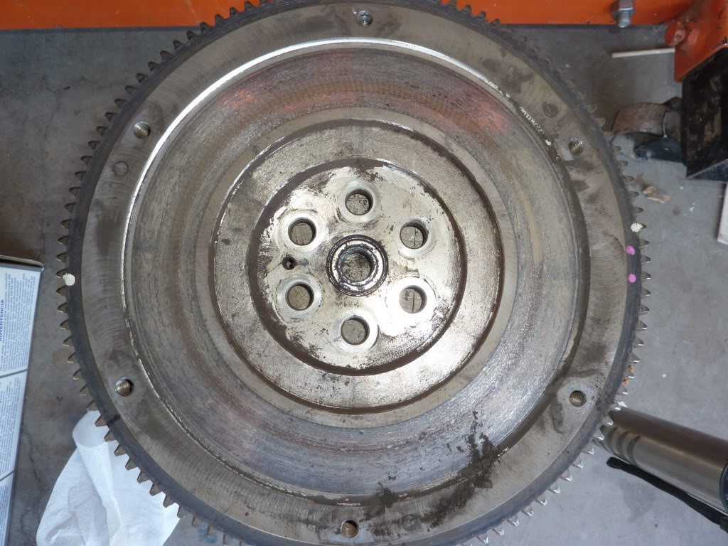

Old FW, you can see the pushed in pegs. Upper left...Upper Right...and bottom center
EDIT: So the old flywheel wasn't done/resurfaced properly.....
The new XTD flywheel lines up with the screw holes and pegs of the old one, and bolts up to the engine just fine. The pressure plate lines up with the alignment pegs/pins and with the screw holes on the new flywheel, but the alignment pins/pegs (whatever you call them) are still too big to fit in the holes on the pressure plate.
