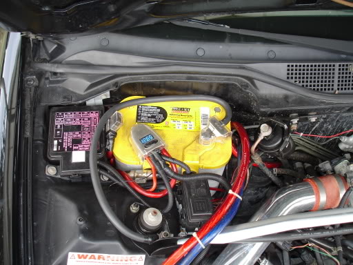

another thing that helps alot with you bass addicts...... fit a larger battery in the stock location
that helped my civics stereo quite a bit itself!
downfall at least for most 96-00 civics is that you have to use a optima sealed battery... cause you have to trim 2 small places in the battery case for it to fit in/ONTOP ofthat battery tray location
one infront for upper control arm, and in the rear for the AC hoses going into the cabin..... but both are VERY SMALL and with a optima yellow top is a sinch! or should i say snip
rear

now it will be tight... BUT it will also fit
http://i40.photobucket.com/albums/e2...wcables008.jpg
just flip the battery plastic tray so it wont eventualy vibrate thru the plastic shell.......
that helped my civics stereo quite a bit itself!downfall at least for most 96-00 civics is that you have to use a optima sealed battery... cause you have to trim 2 small places in the battery case for it to fit in/ONTOP ofthat battery tray location
