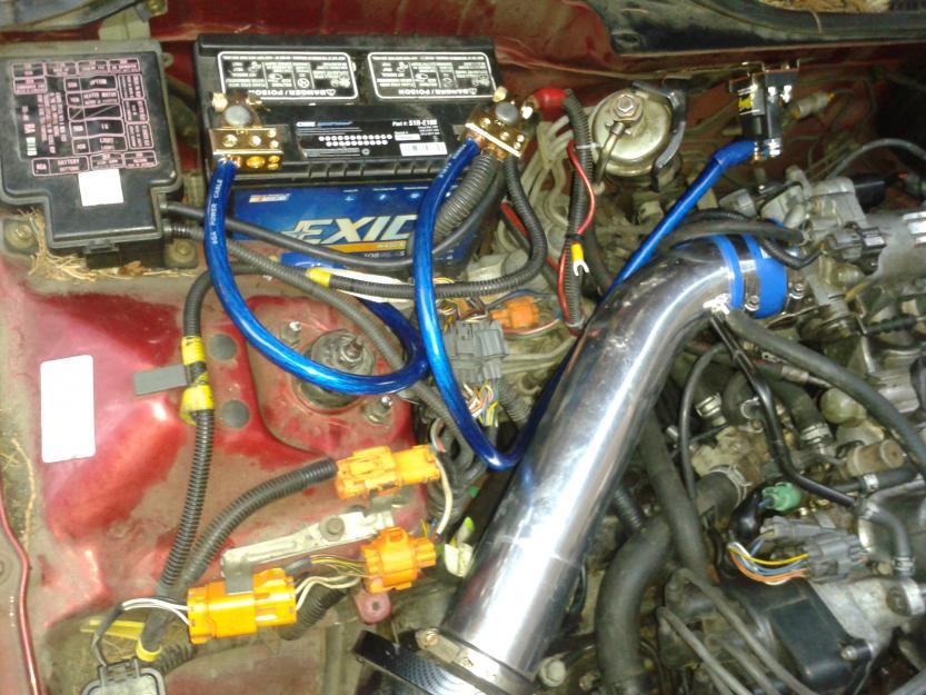

Default the battery
pics of battery,the new connectors and the 0 gauge wire.notice on the fire wall i put an isolator for the dual battery setup.you dont have to do that,butim gonna put a battery bank in the trunk.

lol, why'd you loop it around the power steering resivour (sp?) like that?
I need to do this same upgrade, but without the dual batteries and with much smaller wire...

I am sure it helps with electrical grounding, but good lord you made the engine bay that much more of a wiring mess. Can you tuck those wires a little better?
I guess I am used to the (semi-)"tucked" engine bay look seeing one that is stock frightens me

i didnt want it trunniing acrossed the way it was,just straight across radiator.i was trying to tuck at least that much,hahaha,its pretty hard crap to work with bending wise.i know its overkill for now,but it wont be by the end of summer.4 gauge is still pretty thick,and offers more flex.

cvcrcr,and with the tucking,im gonna get it looking better,but im not done yet,i still have to run 2 more wires that size,3 when the 2nd alt materializes,and then im gonna batten it up better.yes they are laying kind of out there.eventually i should be running the 2- 200 amp alt's,then this wire will make sense.and in the trunk,i have a big deep cycle right now,but eventually im gonna go with 3 or 4 kennetics audio cels,basically a smaller version sealed deep cycle.its kind of ghetto right now,the finished product should be..less imbarressing,lol.
