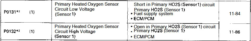

Old Jul 3, 2008 | 03:28 PM
Default RE: VTEC issues
ORIGINAL: bdink1989
its the origianl ecu and i did the cel code check and it blinked once for a air sensor " my intake" and that was it .idk its all gay and i just want my vtech cause its not the same with out it ! =(
CEL code 1 indicates a problem with the primary O2 sensor. Readings from this critical sensor are used by the ECU to determine the proper air-fuel ratio. This likely explains your "VTEC" problem. Clear the code (remove under-hood BACKUP fuse for 30 seconds and then reinsert). If you see the CEL turn ON again when driving, retrieve the code and verify that it is the same. If so, check the circuit and the sensor (see 96-98 manual at link in my signature). It will also help to retrieve the code with an OBDII scan tool from Advanced auto parts to know whether the code is P0131 or P0132.
